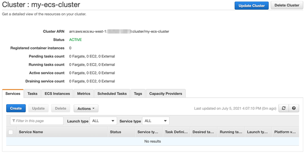

1.4 If successful, the AWS ECS cluster will be created and set as active.
Screenshot_5_7_2021__16_07ECS cluster overview

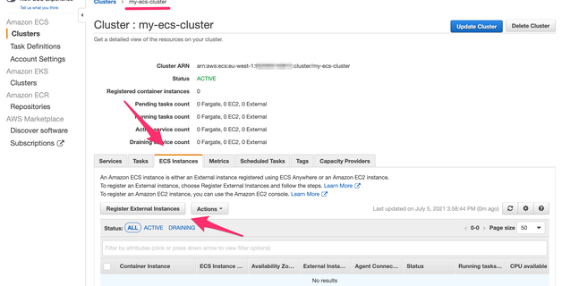

2.1 To enable the Anywhere feature, navigate to the ECS Instances tab and press the Register Externals Instances button to add a non-AWS machine to the ECS cluster.
Screenshot_5_7_2021__15_59-2Instances view in ECS cluster

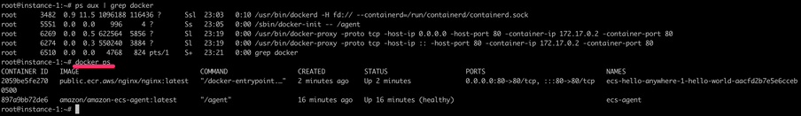

5.5 Go to the non-AWS machine and verify that the task is indeed running there by using the docker ps command.
bruno_instance-1___-1Docker ps command output

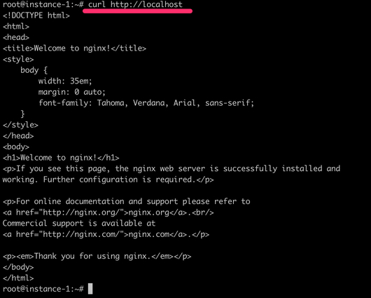

5.6 If you choose the NGINX public container image, use the curl http://localhost command to verify that the container task was successfully started.
bruno_instance-1___-2Curl command output
